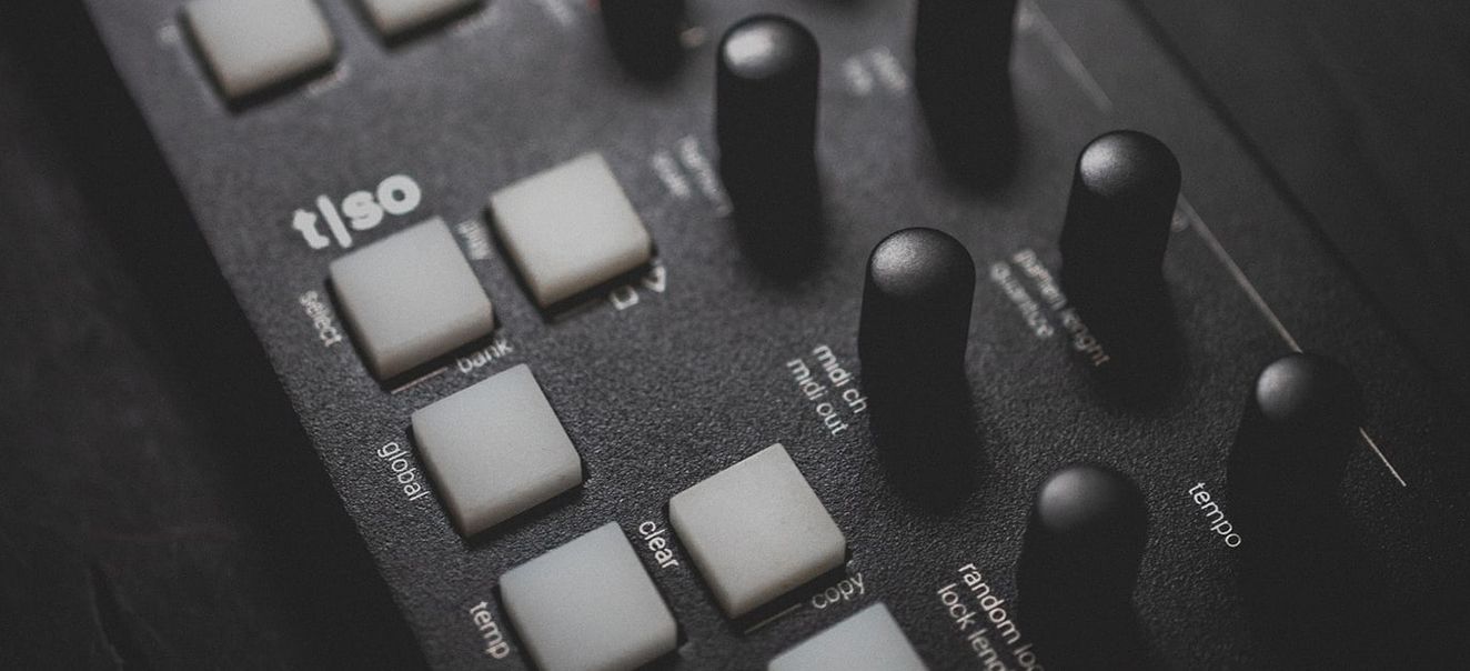

Does anyone here have one of these things? I really love the idea to use this with my baby boy and my wife even thinks it’s an awesome idea, but it’s kinda expensive for the functionality when I think of it as a synth, especially for someone coming exclusively form softsynth world… So any experiences with it? Or fun alternatives?

I can’t link to it because I’m at work, but I think BoBeats took a look at that and he actually has kids, so he might have some insight. He also plays with a lot of hardware, so he might have other recommendations too, IDK.
