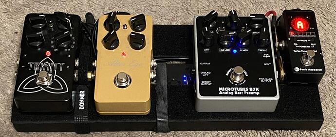

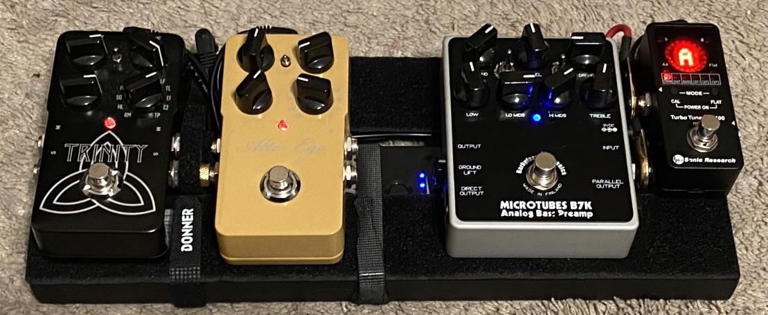

Finally (mostly) wired up my smol pedalboard:
A Pedaltrain Nano someone bought me. The straps are temporary because I’m not sure I want to velcro down the alter ego. The connection between the Alter Ego and Trinity is stereo and 2 straight adapters which showed me things are not so even… they form a shallow, wide “v” or boat hull shape which may be fine when velcro is beneath them, or I just use wires. But it let me strap them down “for now” as I experiment.
The two halves are not connected atm though obviously they easily can be. It’s versatile with the space between them; Between the two TC pedals there is an extra power connector and so I can easily patch in a cable between them that’s outside the board. Strapped in them middle there is this $65 9V DC power bank I got from zZounds called a Rockboard LT XL. It has two center-negative 9V/1A circuits as well as a 5V/1A USB port. As you can see this mounting also gives me access to the power button and battery meter without flipping it over :eyes: I originally got it with hungrier pedals in mind like those Mooer reverb and delays that sucked down 300mA of current or my Zoom that claims a whopping 500mA o.O So many pedalboard power supplies are all “lol max 300mA” or “hah 100mA per connector good luck!” and there’s even a few pedals I was looking at that were annoyingly even 110, 120, etc.
It ended up being very neatly organized, I think. And pedalboards are modular anyway; tear off the bass preamp and tuner and I could fit two pedals easily and possibly a third, and have plenty of power to go around plus portability (it even came with a bag). I don’t know why I like the idea of batteries so much; I guess it just lets me have options and I have a weird obsession with but-I-might-want-to-itis :sweat_smile:
