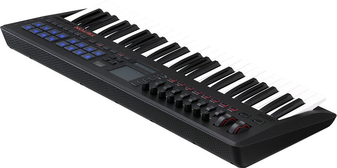

I am late to this party, but I love a mystery. I say it is a Korg Taktile 49 controller
