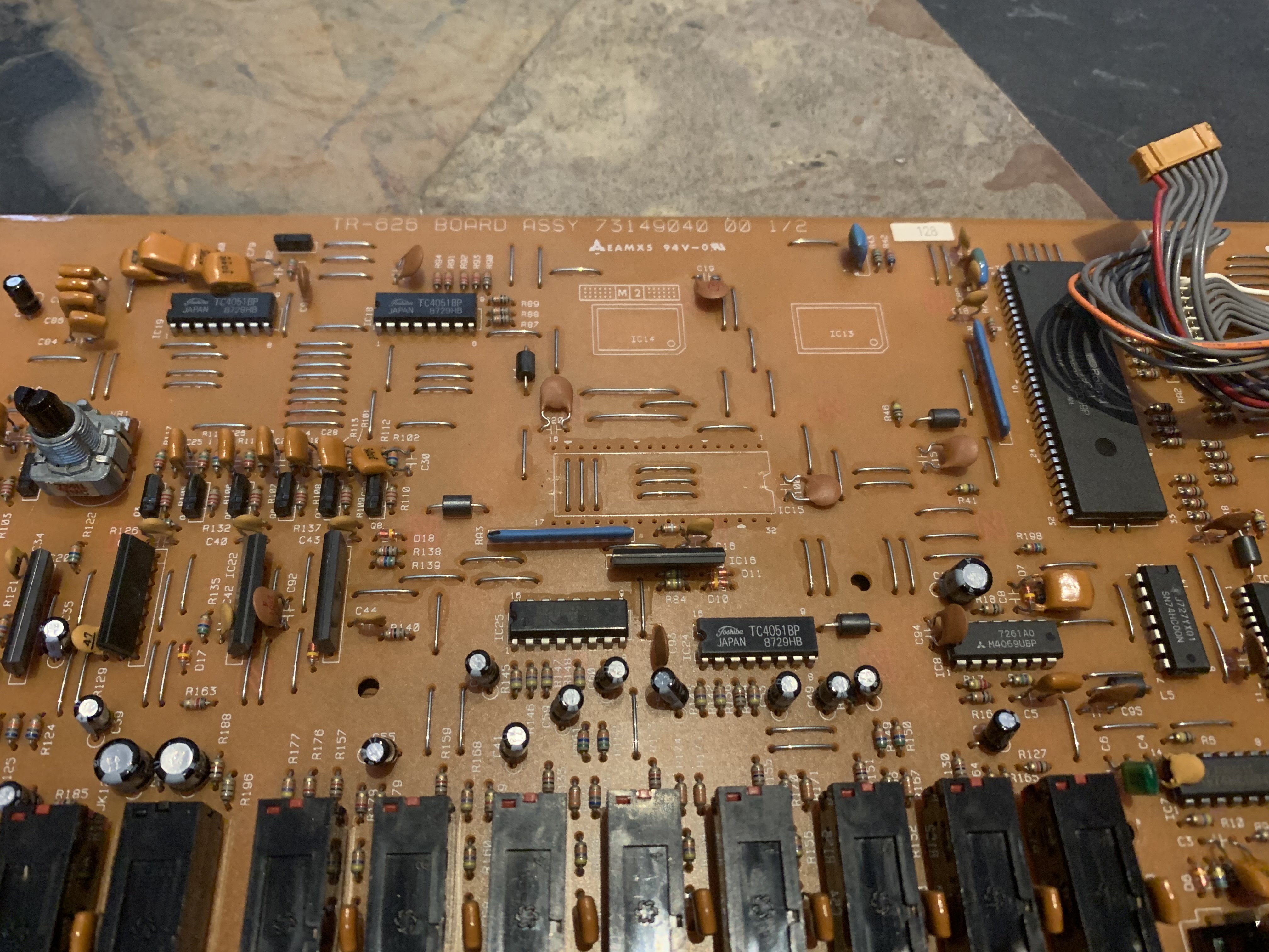

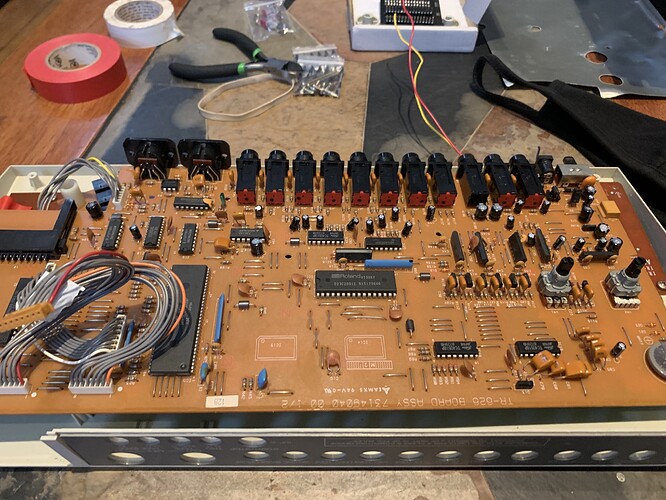

I modded my friends TR626 today. posted on FB about it and Relic suggested i post here as well. Pics and explaination.
Stock Roland TR626. That IC in the center is the sample content EPROM. Its soldered in and has to go! Its a delicate process as i need to keep it in order to allow for the box to operate in “standard mode”

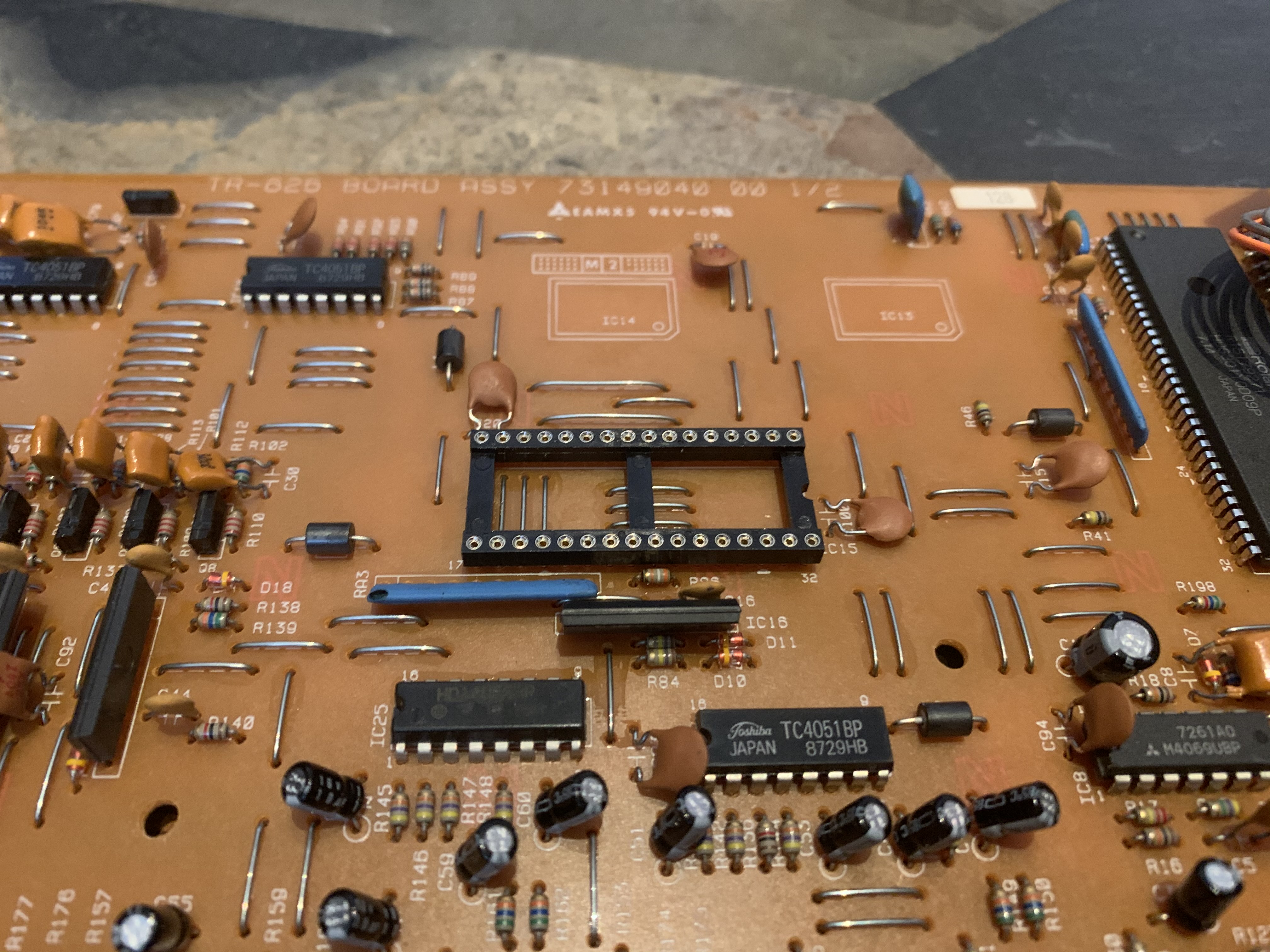

Some time with an iron and a solder sucker (and a few choice four letter words) BADA BING - EPROM removed with no damage to the board, the EPROM or my mental health. (fingers and toes intact as well!)
To save hassles and for future proofing, an IC socket is added, this also makes the IC sit higher, which is clutch in this mod, as the new IC/EPROM is far larger than the old one.

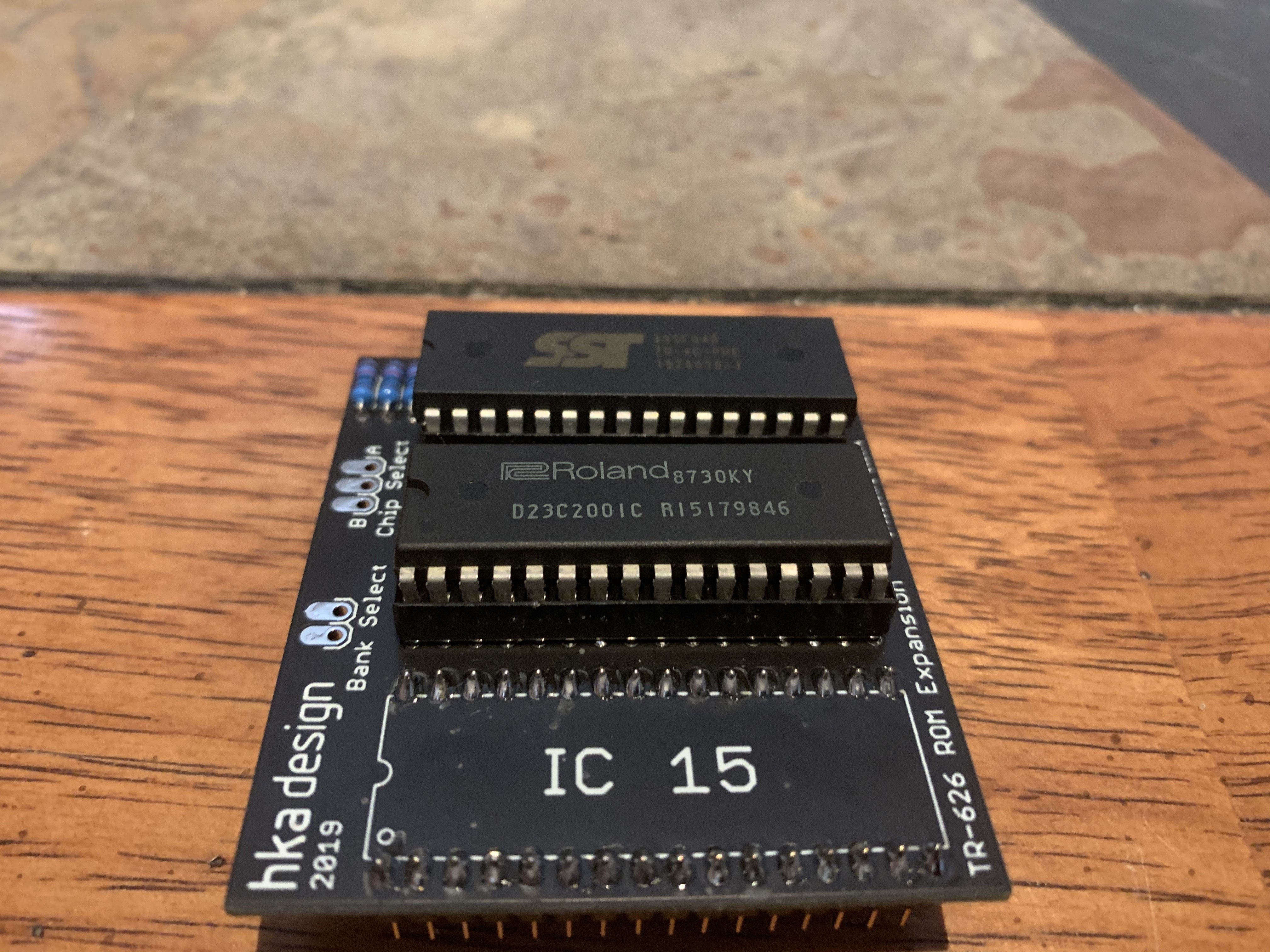

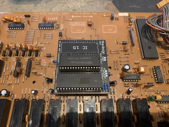

Roland EPROM loaded up into the mod board. The IC behind it is the new sounds, and the pads to the left are for switches that allow for realtime “hot swapping” of the Linn and DMX kits.
as you can see the mod is significantly larger than the original, that socket supplied the additional space so it doesnt rest on any components nor short the board. i originally thought it didnt come with the socket and considered mounting this to the other side of the board to be safe, but it didnt fit well in the case that way and i realized there was a socket (it was underneath some packing material and there was no documentation of its existence)

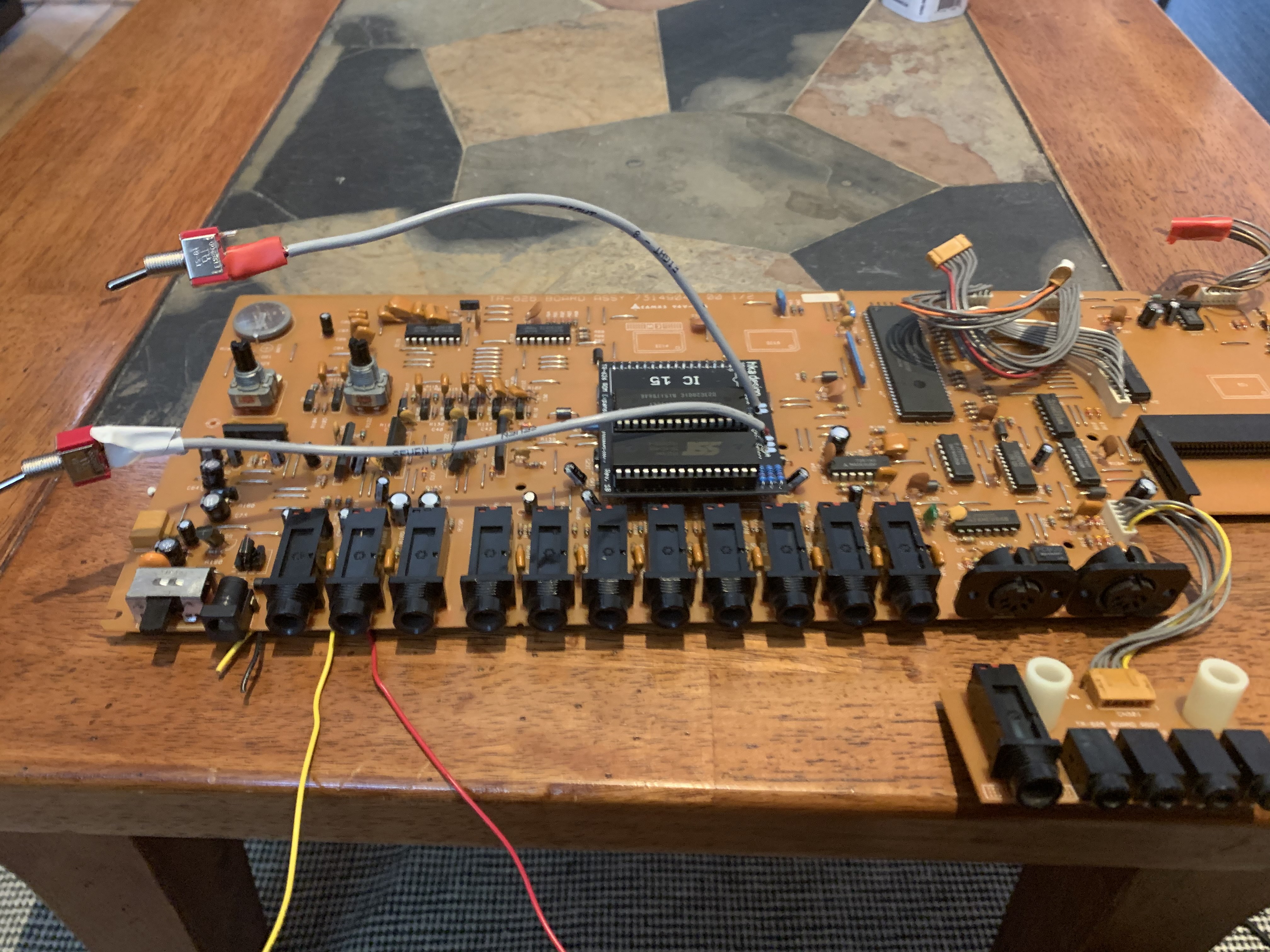

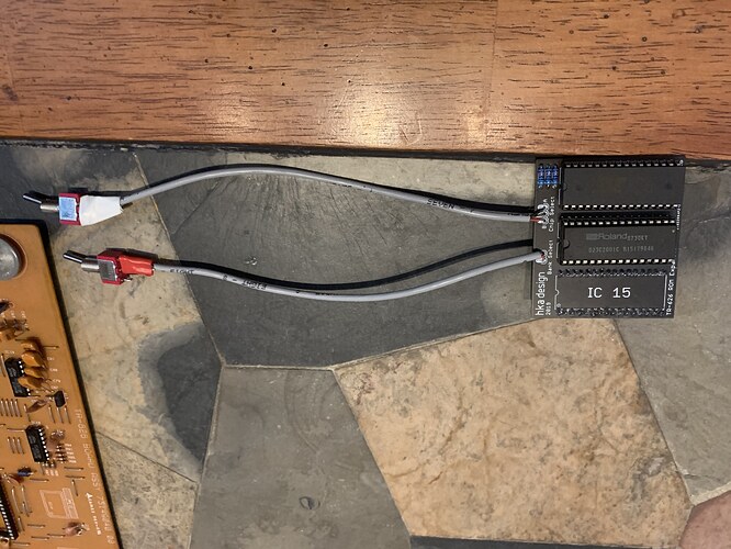

connecting the switches to the new IC.
mod installed with switches in place. i used some old 3 conductor mic cable thinking that it would be more tidy than 5 individuals but the shielding made those leads a bit more bulky than i would have liked, caused a bit of bulge on the 626 case. it was cosmetic only, so i kept it.
drilled 1.4inch holes in the case and mounted the switches.
damnit. i marred the case w my pliers putting those bolts on the pot stems.
I’ve got a video of the thing in action, but i cant post here and i couldnt be bothered to post to youtube but the damn thing works and my client is happy. not a bad friday afternoon.
