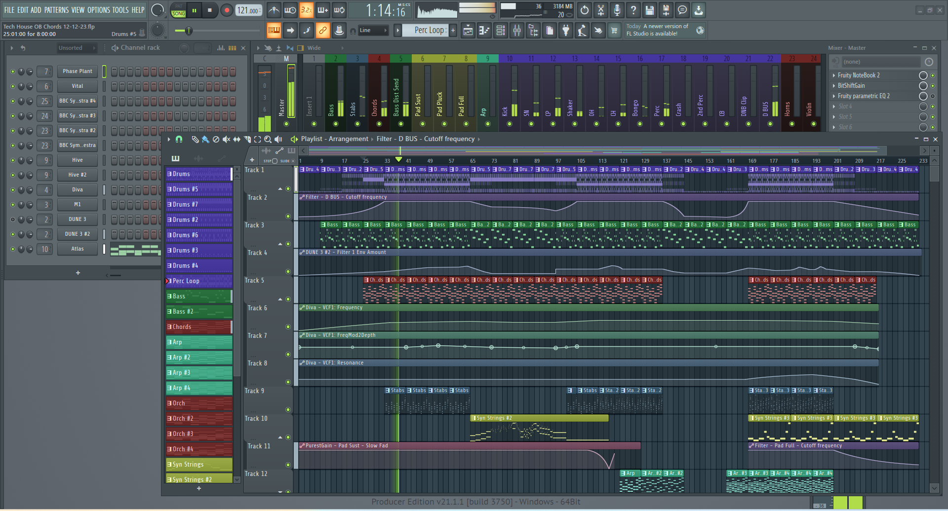

The problem with the playlist is over the years it has tried to be all things to all people. It is the arrangment view where you stitch your patterns together into songs. Then they added live mode and it had to be able to function as a performance space similar to the grid system in ableton (but of course with greater flexibility, because you can put anything on any square, they aren’t pre organized into mixer tracks like ableton). Then they wanted to make it into a linear audio editor like Protools so they added the ability to turn each track into an audio track pre-routed to a mixer track with recording controls on every level. Oh, and also this is one of like 5 places you can work with automation data so it has to do that too.
I have found over the years that my biggest leaps in music have come from better and better understanding how to use the playlist. I’ll send you a screenshot of how I organize things later, but it takes up 2/3 of my screen pretty much all the time. Keep everything in there organized. I put one instrument to one track (say synth one in track one, synth 2 in track two, drums in track 3, etc). I then add automation directly below each instrument it affects (so drum automations, even if it takes 10 tracks, would be on the 10 tracks directly below drums) and if I have too many tracks to fit on my monitor, then I group the automations with the instrument/audio tracks and hide the automations that I’m not editing.
If you need a scratch area for audio editing and ideas, you can drop in a song marker that says “start” and give yourself a few bars of playlist to work with. The start marker is where your song will start rendering and where your play head resets to. Bonus, if you mark the various sections of your song (verses, bridges, tempo changes, etc) those markers will show up in the audio file when you import it into FL later, like leaving yourself helpful notes if you mix stems or master your work as a separate step. In a similar vein the fruity notebook plugin is great. I can leave myself notes of what I think the track needs at the end of a session so next time I jump back in (even if it’s months later) I can remember what I was going to do next.
So this is my default layout when I load in. I have the sample browser set so that it only shows up if I mouse over to the left. I let the playlist be that large and sit on top of everything and then if I need to see something else I click into it and bring that to the top. I can see enough of the other stuff to keep an eye on it, but I mostly want to keep track of the playlist. Whatever plugins I’m working with I keep it to one or two at a time and let them be on top while I’m working with them, but I close them when I’m done. In mastering that part at the bottom left is where I keep youlean loudness meter, and in general during production my plugins are kind of in that area.

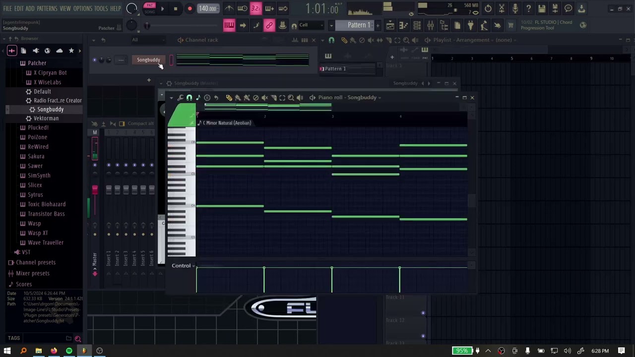

Nag screens be damned, this is a powerhouse. The piano roll is now the most overpowered of its kind in existence. I wish I could just detach the piano roll itself and stick it inside of Bitwig or Renoise.
Still looking for some way to get patcher to handle MIDI note FX, since it picks up on their I/O just fine yet somehow (seemingly) sandboxes itself away from system calls. VSTs also don’t seem to be able to call up MIDI devices and loopbacks, leading me to believe that FL is indeed closing off everything that isn’t FL studio, since other DAWs allow you to route things to wherever.

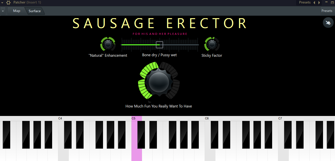

NGL this is kind of hilarious. Yes, I just discovered GUI elements last night. No, I will not be getting any sleep tonight
I’m an FL Studio fanboy, but their native tools are all pretty good.
Damn, they need to get their fucking numbers straight
(more bitching)
I end up having to do bullshit like this just to get their counter element to work correctly. I’m glad that it does, but their numbers aren’t rounding like they should and they don’t let you duplicate anything in the Patcher. God forbid they make our struggles just a little easier :smiley:
On one hand I’m glad that it’s this capable, but on the other it feels so goddamn half-baked

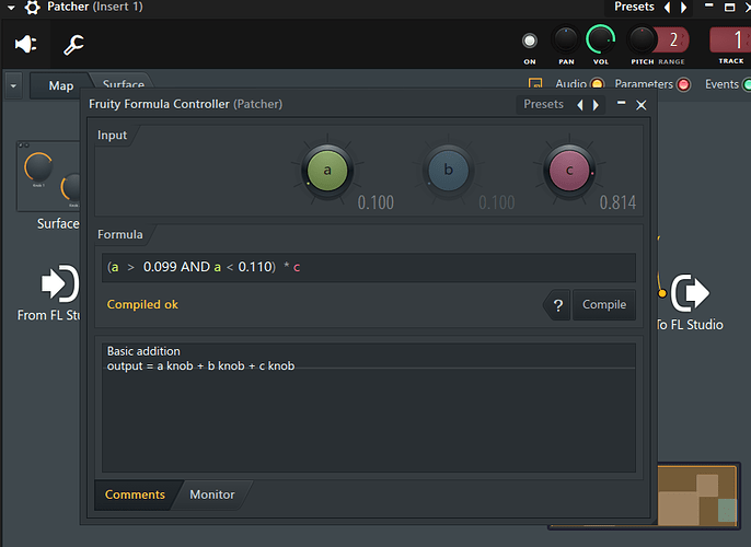

Looks like the formula controller’s ‘rand’ function is going to be your best bet, if you don’t want to use anything external and basically want it to recur in real time. Interesting topic, and I’ll exprriment with some rigs when I can to see how practical it actually is in the real world. Converting RNG to pitch data is a breeze pretty much everywhere aside from FL Studio (Renoise and Redux kind of excel at this kind of thing natively) but I’m certain there’s a solution here, too.
Also, welcome to the forum!

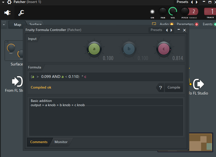

Alright, I got something working. So unfortunately it uses PlugData s a dependency, but all you’ll have to do is make sure that the PlugData Clap is installed on your system because I’ll be making a simple GUI that hopefully fits what you need.
I didn’t have to do it this way (I just wanted to involve as little PD as possible as a challenge), but it uses the formula controller for a random value and I created a sample and hold in PD that locks down the value and outputs it. This is normal sample and hold behavior (meaning you get a stream of random notes in real-time that you can skew to your liking), but it’s cool to have a patcher version that works for FPC. Plus, you don’t need to be a modular nerd for it to work, and that’s the idea.
I’ll upload a prototype soon and then you can let me know what could be better. Skewing the values so that they work with FPC will take a little bit of finetuning, but that’s always kind of fun in my book. Hopefully I can make a snazzy GUI to coincide with the important features
I also want to sync it to FL’s ‘songtime’ parameters so it makes sense to use it in FL projects without worrying about sync issues. Thankfully, they give you all of that stuff with the Formula controller so you don’t have to use any other plugins – if only they gave us the S&H capability :thinking:
