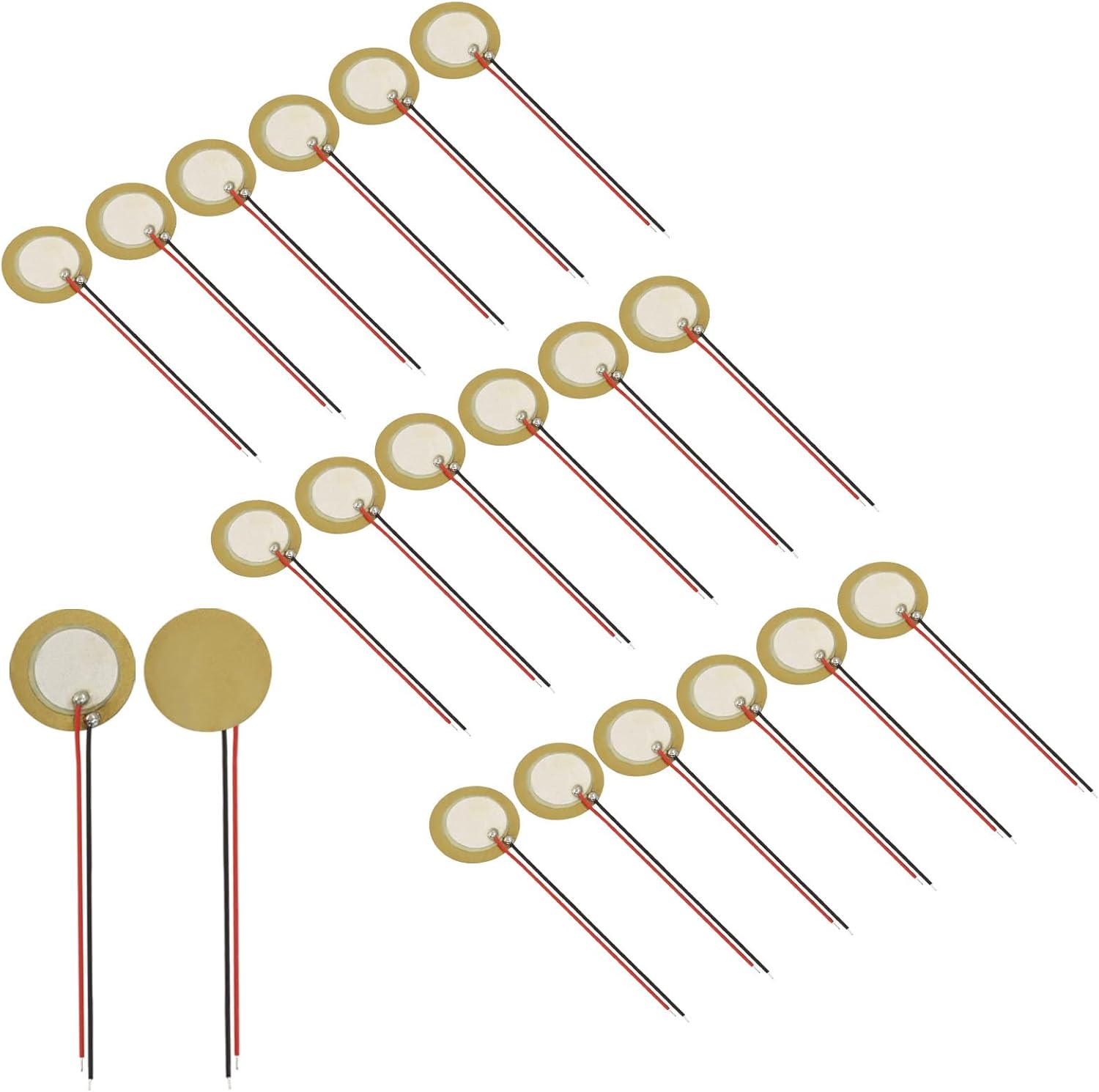

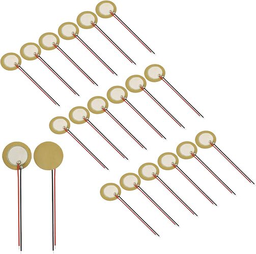

Does anyone recommend a decent piezo? I mean what’s up with these?
They’re fine. It’s all mostly the same shit in a different package - like if you buy a cheap “acoustic guitar pickup”, it’s just one of those (or something very similar) in a nicer package, like wax dipped or padded or plastic cased with heat shrink and a real cable at the other end. We’re talking $2.50 worth of parts and half an hour of work. Super easy to DIY if you want. For the cost, fuck yeah, get some and play around. They’re a blast.

The problem with piezo material, besides being black magic crystals from planet Xenu, is it naturally has a stupid high impedance, like 10M ohm. That’s an order of magnitude higher than anything you’d normally find in a studio, so even with a really nice audio interface, you’re going to have a major impedance mismatch. A piezo is basically a capacitor (if you whack it, it makes a voltage), and capacitor (piezo) + resistor (impedance mismatch at the preamp buffer) = high pass filter. A real gnarly one because of the size of the mismatch.
That means soldering a 1/4" cable to the end of one of those and plugging it in gets you seriously reduced bass response, ‘screechy’ highs and a midrange honk. Probably doesn’t matter for some uses, but it is a common complaint, especially when using them to mic acoustic instruments, and you definitely are reducing your frequency response by just rawdogging the disk in most cases.
So why pay more for one of these? Because really nice ones have an inline preamp with buffered output so they sound really good and have a flat frequency response. Like if you’ve got a $100k cello you’re trying to contact mic, you don’t want to throw a $1 disk on it and lose all the character. Necessary for sticking in a shoebox with some springs on it? Probably nah.
I know Radial makes a DI box specifically for piezos (SB-4, maybe?) and there’s a ton of pretty easy diy plans for them on the internet. I have a couple I made in Altoids tins and I’ll attest it’s a night-and-day difference, but again, not really necessary for just messing around and getting sounds.
one of the guys I was watching used some cheapy DI/preamp from Art for the piezos, similar sort of thing. I also want. to say I’ve read that the bigger the disc the better as far as frequency response goes.
@wayne you can even find those piezo discs in triplets pre-wired to a 1/4" jack.

Yes no maybe kinda sorta. Increasing the surface area lowers the fundamental vibrational mode, so you get a resonant peak at a lower frequency but not a change in overall frequency response. That can be good depending on what you’re recording, but you also get higher impedance at lower frequencies, so while you’re emphasizing a lower frequency with a larger disk you’re also increasing the high-pass filter effect which sort of cancels it out. tl;dr - bigger disks can help with low end, but only after you’ve done some impedance matching to fix the HPF.
