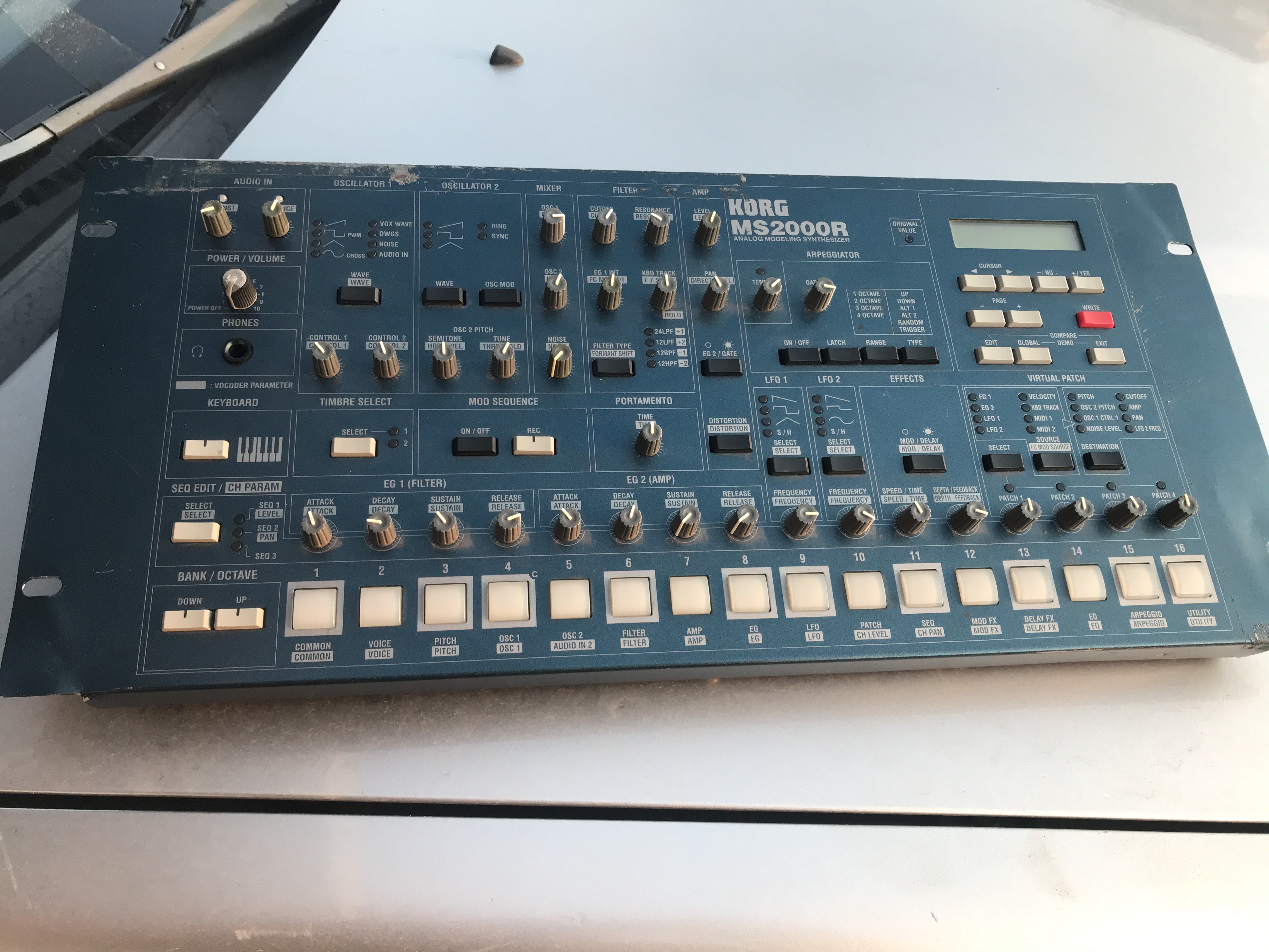

So… I went and got the MS2000R!!!
It is pretty beat up, there’s quite a bit of wear cosmetically, and the rack ears are kinda bent up. It’s definitely gonna need some work to get going, but I’m hoping to make it kind of a project. It did NOT come with an adaptor, but I have an extra one and I ordered another anyway. I was able to talk the guy down from $250 to $160!!! Partly because he found another issue with it, besides the screen cutting out until it gets smacked, the headphone output apparently cuts out as well unless you jiggle the power knob. I haven’t opened it up and checked it out yet. Also, the switch on the back that changes one of the inputs from line to mic level is loose, so I’ll check that out.
I’m pretty stoked to have gotten it so cheap, but it is going to need some work. Most of the MS2000r’s I was seeing have been going for $375-425, so if I can get this working, that could easily be a nice profit.

So, so far I’m actually pretty pleased with this unit!! It powers on and I can play the presets, which are filling me 90’s/00’s rave happiness. I’m thinking that all this thing actually might need is just to get cleaned out.
I took it apart, and there is a bit of dust that’s built up around the components. The issue with the unit cutting out and need to be smacked seems to actually only effect the LED backlight, so you can actually still read it, tho I guess it could be troublesome in low light environments. As far as the headphone output, I feel like I am noticing it cutting out a little, but when I was troubleshooting it and trying to recreate the issues, I smacked it and suddenly there was just weird noise coming through and no response from key presses, tho the unit was still on. After taking it apart and simply blowing off a bit of the dust, it seems to be working pretty ok, and I even tried shaking it and the signal didn’t cut out. The LED does stil lose the backlight, but that’s not a huge deal.
So far, with a little bit of thorough cleaning of parts and pieces and things, it’s working pretty well for getting it for $160.

I’m glad it worked out for you! Sounds like none of it was too big a deal. I would stop smacking it, though :wink:
Were it me, I’d give it a thorough going thru - blow & vacuum everything out, contact cleaner on the knobs and jacks (tarnish, man, tarnish), check that everything is nice and tight as far as mechanical connections. Given the backlight problem, I’d check every point where something attaches to the chassis, because it’s likely a ground issue. There’s likely a ribbon cable of some kind from the screen to the PCB, that’d be another likely point of failure.
Anyway, congrats on your dance machine, sounds like a lot of fun.

Seems all the chips and major system components are working fine on the unit. The backlight still is cutting out, but also running onboard diagnostics the system finds a short. I’m working through schematics now trying to track down where the problem is occurring.
