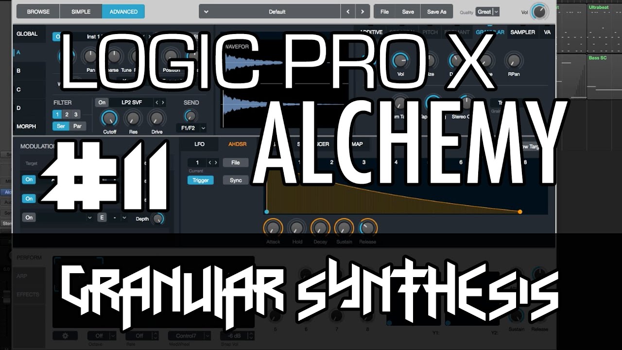

I know in alchemy this can be done by doing the following:
Import Audio onto a new location (A, B, C, D). Choose to import and analyze by way of Sampler mode.
After the sample has been imported, click on your desired oscillator (a,b,c,d).
Set the speed to 0, and use the position knob to scroll through the sample.
And either use latch to Create a automation, or just set the start of where you want the first sample, and then hit the A button on your keyboard to open up automation lanes. Then draw in where you want the positions of the sample to change.
here’s a site that explains it a little better, but on it they discuss using granular synthesis:
https://www.musictech.net/2016/03/logic-granular-1/
As far as using the EXs for sample manipulation I’ve found that it works best as a re-slicer. Ie. bringing in REX files, and creating new vectors. The vectors can then be made out to a midi file, which then can be altered to change positions of samples/slices v.i.a. the arrange window.
Hope that helps.
