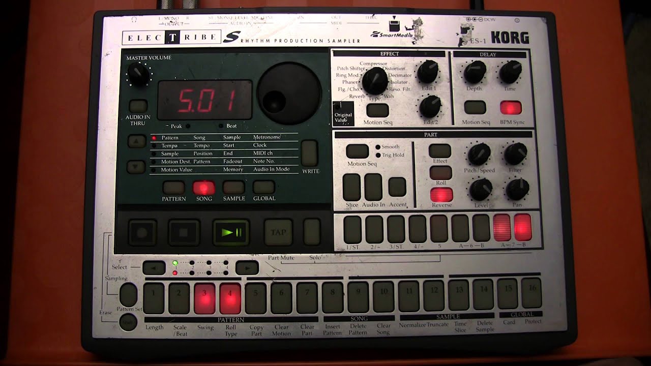

Start with one bigger piece and see how much mileage you can get out of using it by itself and then start filling in the gaps slowly. For example, something like an Octatrack, which would be the brain of the whole thing because it’s a sampler, midi sequencer, fx processor, mixer and it’s very performance oriented in its design. Used MK I can be had for around $800 now. But maybe that’s way outside your budget, so then maybe look at some grooveboxes, like Electribes or something. But, really, people do all kinds of great shit with just a bunch of Volcas, so you can use just about anything and see how much you can squeeze out of it.

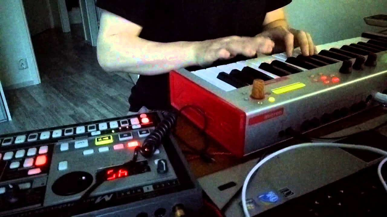

If you want to perform live, keep the setup small, portable. You don’t want to drag alot of stuff because you not only have to carry it around, but also connect it all, and the less stuff, the less problems. It might seem easy to hook up a drumcomputer, a few synth modules, a mixer and fx for instance, but to get the audio, midi, power, clocks etc right in poor lit conditions, maybe under stress, can be quite challenging.
