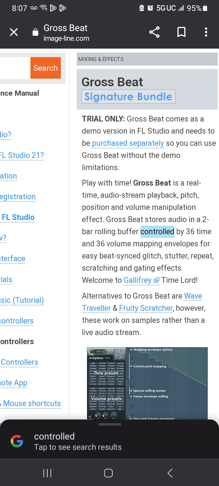

I don’t know what gross beat is (yet) but all of the other stuff is very possible.
