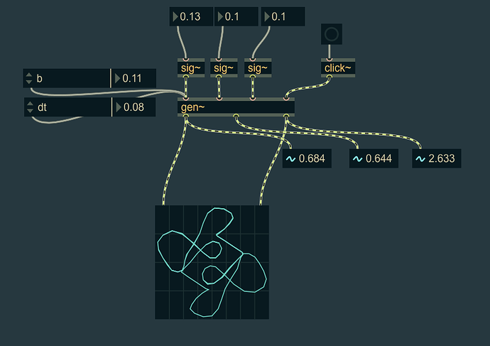

I don’t know if this is of interest or use to anyone, but I just got done refactoring some very old Max patches for Lorenz and Rossler attractors using gen instead of some ugly kludges from the olden days. They seem pretty performant though there’s probably some more cleanup I could do.
Currently looking at using the numeric output to drive some of the sampler slicer parameters - scaling is weird depending on the attractor settings so trying to tame that; still not sure if it’ll be useful. The do make cool sounds if you dump them straight the the DAC and play around with the numbers.
Max Lorenz Attractor

Not entirely sure what I’m seeing here but it sure looks cool.

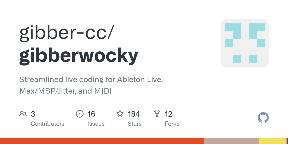

Looked at this a bit more, it’s apparently using a project called Max_Worldbuilding_Package that adds connectivity for some VR environments and a generalized websocket into Max/M4L. Gibberwocky then hooks into that websocket directly from a browser to pass JS into Max and parse it real-time. So all the under-the-hood processing is in Max, it’s just using the browser to update the Max scene.
Worth pointing out that the whole thing is really old - Worldbuilding is 9 years out, Gibberwocky looks to be 7-8 years. Gibberwocky is from Graham Wakefield who is the guy that initially wrote gen~ for Max so I’d guess the system is solid as he definitely knows what he’s doing, but my guess is it was a quick “oh, I bet I could do this” thing and not a serious long term project. For all I know there are now built-in ways to get the same functionality.

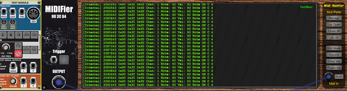

Damn, I think all of this dicking around has payed off a little; I finally seem to understand a little bit more of the development and debugging process thanks to prototyping ideas in like 50 different strung-together environments. It seems like the messy way paves the way for the clean version, and sometimes you really do want to bottle something up into a neat(er) package.
Last year (or maybe two years ago?) when I last tried to make a MIDI-generating module, I was completely lost with Java’s ridiculous libraries and constructs, sticking the MIDI operations in the DSP-ready / sample-rate sections (ouch) and not being mindful about callbacks and such. Now I’m basically just down to parsing this thing correctly so I can load it up with raw bytes on the fly. I should have listened to @Artificer about breakpoints and debugging back when I was struggling so hard, but I guess it was mostly a stubborn mental block.
Honestly I can’t believe how much debugging shit is here after poking around. I’m probably going to be able to fix a bug of theirs that’s been chilling for a long time (they confirmed I was right and never touched it), unless it’s some part of the API that’s got an issue.
