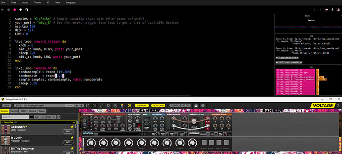

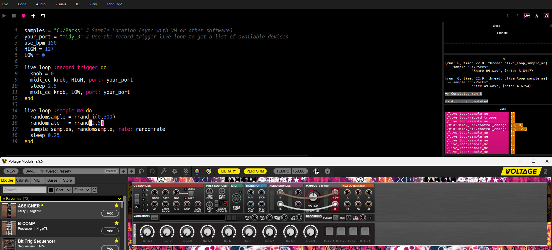

This might be the perfect sweet spot for me. You can see the MIDI live loop is just triggering the record button periodically, and inside of VM, you can set the folders to sync up so that they get dumped into the same place. Obviously adding probability into the equation and even some FX (no matter how hard they drag the system down at times!) could make for more exciting performances and outcomes.
The output of Sonic Pi is just going directly into VAC, so VM is also being used to eavesdrop and record. Pretty convenient for a janky solution :smiley:
samples = "C:/Packs" # Sample Location (sync with VM or other software)
your_port = "midy_3" # Use the record_trigger live loop to get a list of available devices
use_bpm 150
HIGH = 127
LOW = 0
live_loop :record_trigger do
  knob = 0
  midi_cc knob, HIGH, port: your_port
  sleep 2.5
  midi_cc knob, LOW, port: your_port
end
live_loop :sample_me do
  randomsample = rrand_i(0,300)
  randomrate   = rrand(2,5)
  sample samples, randomsample, rate: randomrate
  sleep 0.25
end
The only part that’s missing is file management, so to keep up with the janky spirit, I’d probably just make a tiny Python script do some of that. It doesn’t really have to sync up too well for me, provided it doesn’t pull something that’s currently running. That might be the real challenge :smiley:

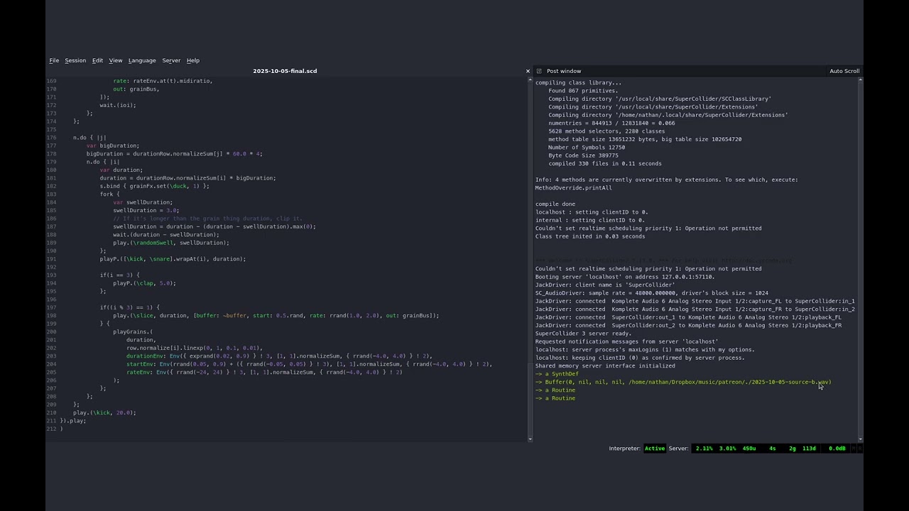

Simple example: loading a sound file into a buffer
// Read a sound file from disk into a buffer
s.boot;  // make sure the default audio server is started
p = ExampleFiles.child;  // ExampleFiles helps locate audio files used in examples
p.postln;  // peek at the path to see location and the format of a path
b = Buffer.read(s, p);  // read the file
Based on the definition: Buffer.read(server, path, startFrame: 0, numFrames: -1, action, bufnum)
Buffer | SuperCollider 3.14.0 Help
A bit more convoluted than Sonic Pi, but nothing too crazy if you just look up the definition of Buffer. Now you have a buffer in memory you can play, edit, granularize, put through a synth or effects, whatever.
