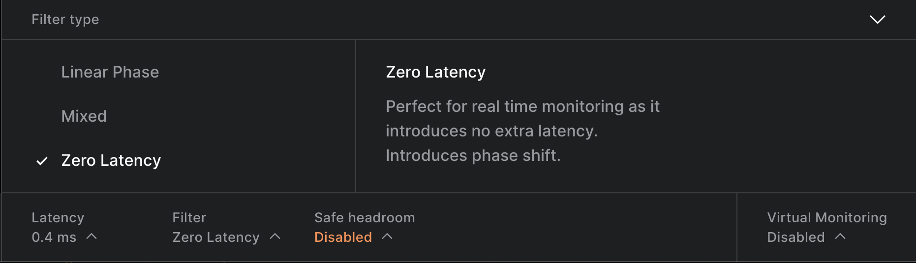

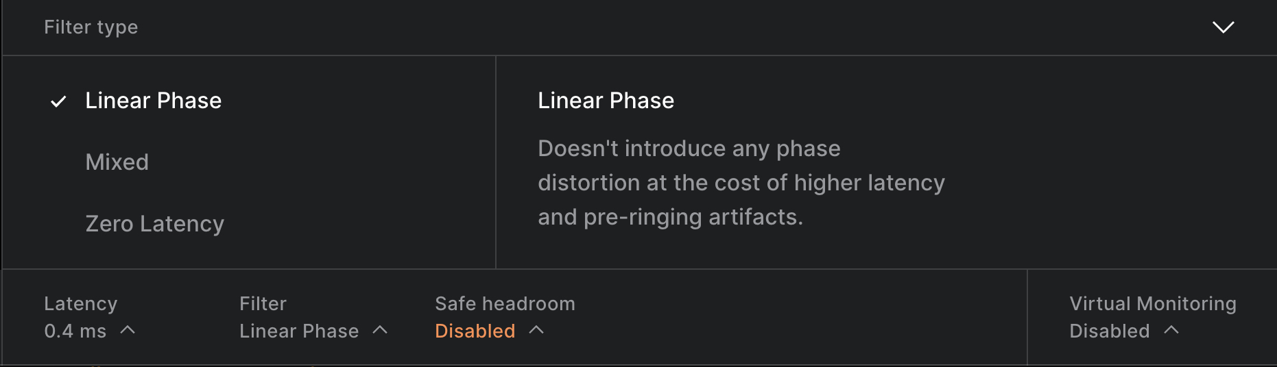

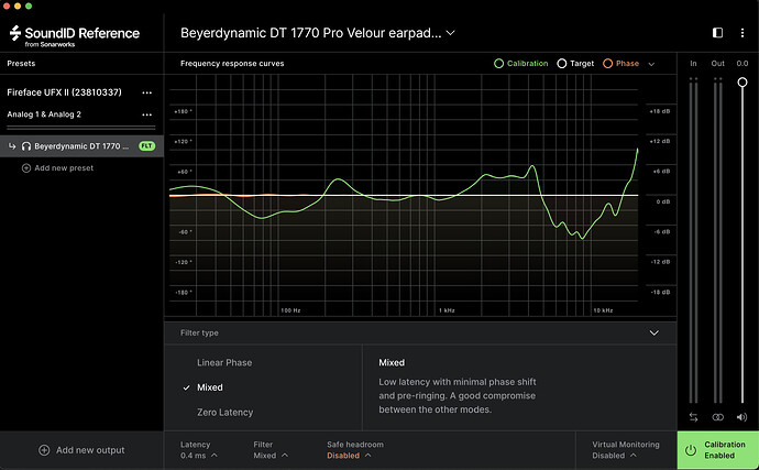

I’ve been using Sound ID Reference since day 1 & trust me … it really makes a difference. I remember using HIFI headphones which were in the list of the supported headphones back then, i needed a flat frequency response to work more accurate mixes & this tool does it perfectly. That being said, this tool is not a swiss army knife or a magic tool. It just gives the most neutral frequency response needed to get good mixes. There is a workaround to avoid paying the price of this plugin. Get the frequency response curve of your headphones, should be supplied somewhere on the manufacturer website … get an EQ … curve the EQ the opposite curve as the response you get from the specifications & there you go … flat response … i’ve done it & it works… the thing is that not so many manufacturers supplies the frequency response curves of their headphones, specially now that sonaworks is in the game … but this tool really works …
The only thing to consider, & is pretty important, is that, according with the chosen setting of the filter type (which is an entire part of the tool) you get a different result & for some, are pretty audible …
I always set it to MIXED so you get a balanced of the three filter types & then a not so audible artefact.

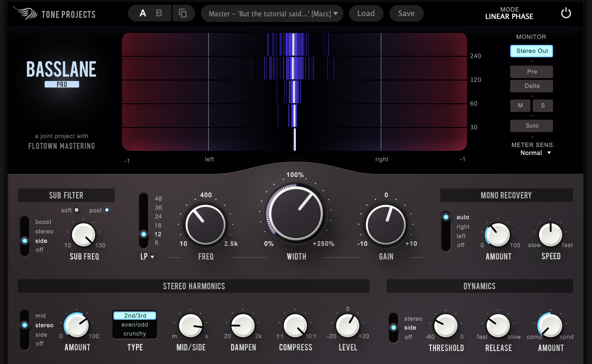

So now, after all this, to make sure i introduce as little phase issue as possible i put an other plugin after Sound ID Reference on my MASTER & this one is a real game changer …
BASSLANE PRO
This plugin is a real game changer …
