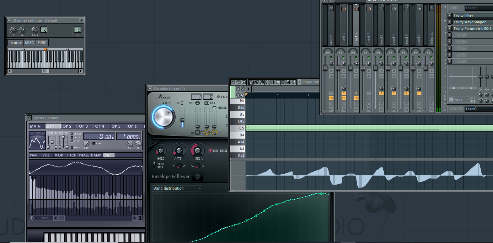

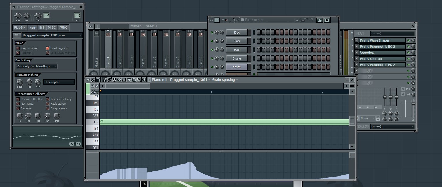

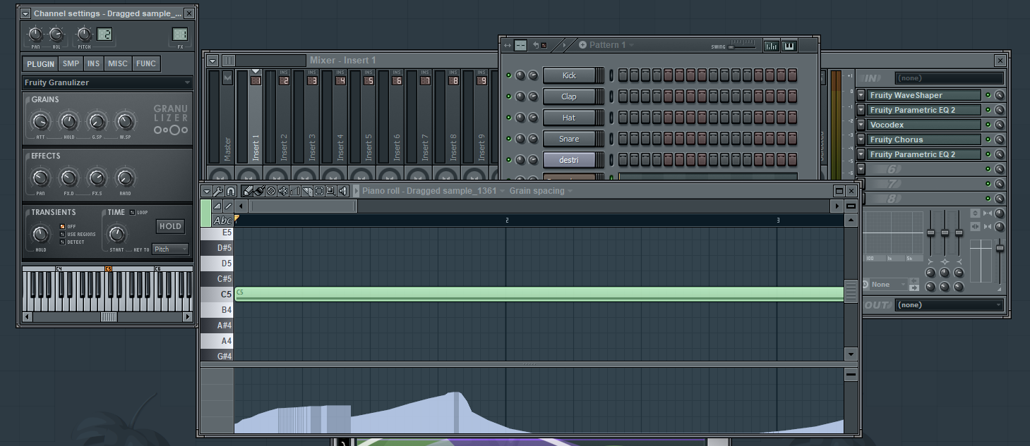

i took a sample of some drum thing i made and ran it through a granular synth, i played around with the timestretch algorithm and automated the parameters of the granular synth, and used the same sample loaded it into sytrus to fm mod it and had the fm mod sample modulate the granulized timestretch sample using vocodex, + distortion + highpass fliter automation + some eq
i took screenshots to better explain what i did:
and here is the resulting sound:
grain bass sound
Really nice result, very metallic, very digital!
