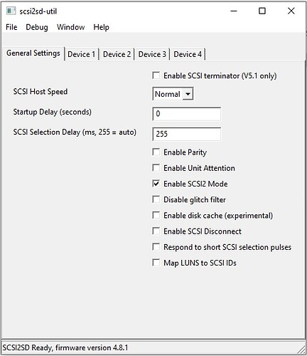

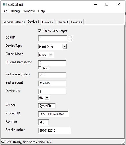

I have a Korg Triton “Classic” and the SCSI2SD emulator V5 (the small one).
I use a 16 Gb SD card but when I select “Scan SCSI device…” in the Triton / Media info menu, no SCSI ID is recognized (?)
What are your settings for the SCSI2SD emulator please ?
You can see them with the scsi2sd-util.exe utility. Select File / Load from device.
If you can post the screenshots corresponding to each parameter tabs it would be very helpful :slight_smile:
Hello,
So I finally make it working far into last night :wink:
Here are my settings and how I proceed so it can be useful for anybody.
I’m using the SCSI2SD emulator V5 version (the smaller one) with a 16 Gb micro-SDcard.
  1. Configure the SCSI2SD emulator for 4 partitions (max size partitions for Korg Triton is 4 Gb) with ID = 0, 1, 2, 3. NB: Mine is configured for 4 partitions of 2 Gb with ID = 0, 1, 2, 5 as I use it also for an Ensoniq TS-12. Configuration can be done using scsi2sd-util.exe free utility available on SCSI2SD website.
