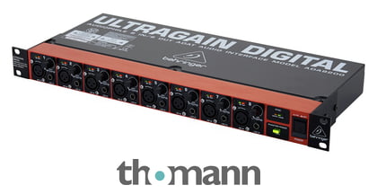

That is true. I think it was @chasedobson told me that Behringer makes a pretty damn good ADAT. If you do your research you might be able to find an older model interface that links up with another of its model easily. At one point I almost bought another MOTU 828 MKII because apparently you can just link them easily to double your inputs.

I have a focusrite 8i6 with no adat connection, i have a semi newly bought m audio m track 8 with no adat connection. It would mean buying another interface and an extension and would cost me hundreds more than the zoom mixer and i would have to turn a computer on for it to work.
