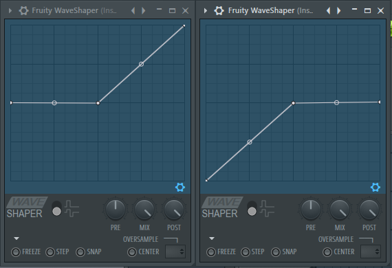

Another fun thing you can do with the fruity waveshaper, is filter out the individual polarities of the waveform (or full on audio) and then process those separately. Technically, I’d still call that distortion as it’s dependent on gain dependent transfer function to make it happen. Anyways, just route audio into two send channels, with one waveshaper set on each to cancel out one of the polarities of the signal. Then you can process just one polarity of the audio. If you route Sytrus right, you can do it with the filters in there as well.Ultra%20distortion

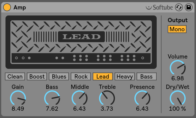

Lots of cool stuff already has been mentioned and I just want to add Live’s Amp. I use it way too often because it sounds so sick. Gain and Dry/wet automation does wonders. Very crushing and crunchy, especially Blues, Lead and Heavy modes.

I really need to learn how to use the Fruity WaveShaper. Some of the presets sound cool on the right material, but when I step out on my own it just makes a mess of the signal lol.

I only know the basics. The closer you are to a straight line, the less distortion. The smoother the transitions (IE using curves instead of angles) the less fuzz you get. A very basic distortion for analog warming purposes would be to just open it up, and then put an upward curve in the line to taste. That’s your analog distortion model right there, and it’s how I use it 95% of the time. Image line just has the habit of letting people do whatever with their stock plugs, and that means they usually let users go way, way farther than they need to for most common use cases.
BTW, the default view is mirrored, so you don’t see the negative polarity of the transfer function, but it’s a mirrored copy of what you’re doing on top. If you flip that switch at the bottom, you can edit the negative and positive polarities of the transfer function separately, which is what I do to filter away one polarity of the signal. Then you put a flat line in the middle for either the negative polarity on the left or the positive on the right, which just makes any input on that side go to zero.
@bfk The only difference between compression and distortion is the attack/release a compressor gives. Think about it, if you put a signal into distortion, like the waveshaper, you change the output level for a given input infinitely fast based on the function you define in the window. A compressor changes the output level for a given input level based on the threshold and ratio settings as fast as the attack and release allow. That’s why, when you’re compressing bass, you have to back way off the attack and release so that the compressor can’t change level too fast and cause distortion. If the compressor changes gain faster than the wave changes level, it modifies the wave shape instead of the volume of the wave, and that’s distortion.

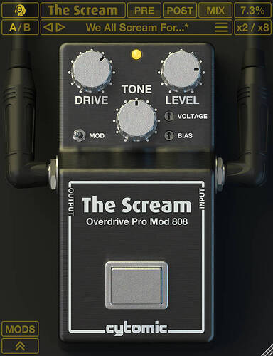

I own all the usual suspect distortion plugins but to my surprise the one that is seldom mentioned is Cytomic “The Scream” I’ve been using it for sometime now its an amazing pedal emulation of the 1979 Ibanez Tube Screamer, the drive and tone just scrunches my munchies.
Its been in beta for ages because in the finished version you’ll be able to choose your own components to build any pedal you want swapping them around on the PCB, so its taking a lot of work/research as he models various diodes, transistors, capacitors etc available on the market, however for £30 the beta works perfect and totally destroys the UAD version in terms of realism.
My number one plugin for getting that Alessandro Cortini driving sound.
pictured is the beta i use, the finished version will look more like the original green pedal.
