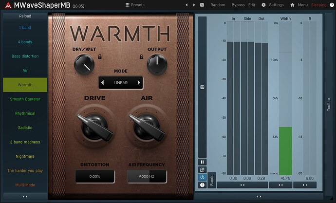

MeldasMBwaveshaper can modulate any point on the X-Y axis with LFO,envelope followers,velocity and pretty much everything you would associate with modulation

last i remember most of the parameters in Trash on the waveshaper side of things do not have their params/sliders and such interpolated.they click and "zipper"quite audibly when you drag them.they might have a addressed that now as truthfully i haven’t bothered with Trash in years since getting MWaveshaperMB
You can automate the transfer curves in all the plugins i listed definitely.whether it’s useful is a different story and entirely up to personal taste i guess(ya right it can sound kinda pointless)MWaveshaperMB can do parameter updates at close to audiorate at the expense of A LOT of CPU use
