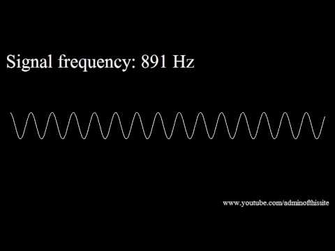

Start with the basics - physics and math! (just a lil bit, I promise) All sound, literally everything we hear, is made up of waves. A sine wave is just that basic up and down wave you see everywhere. How big the wave is top to bottom is how loud it is (amplitude) and how fast it is (how close together those high and low parts are) determines the pitch (frequency). You’ll see people talk about A440 - that’s an A note at 440 Hz. Hz is Hertz, which is just how many times that wave is repeating a second.
So you’ve got a sine wave repeating a certain number of times a second. It looks and sounds like this:

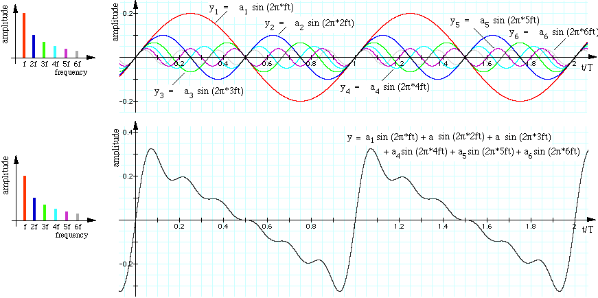

Pretty boring, eh? But - literally every sound everywhere can be deconstructed to a bunch of sine waves. How? Because when you play two waves together they add and subtract (technically called wave interference). Add the exact opposite of a sine wave (a cosine wave) to it and you get zero, nothing, silence. Add two different sine waves together and you get the sum of their peaks and valleys (I’m obviously simplifying here), but it’ll sound different than just a basic sine wave. Add a sine and a square wave and you’ll get a sort of half-way thing between them, because some parts are adding to the wave and some are subtracting.
(ignore all the math in there - if you add all the waves up top, you get that wave on the bottom!)
That’s how synths work - they use oscillators that make waves of different kinds, and add them together and do cool stuff with them. Some really cool stuff, but in the end it’s just manipulating those basic waves. Most synths have multiple oscillators so you can add two sine waves, or a sine and a square, and offset and mess with them in interesting ways. It’s just adding up the stacked waves and what comes out is what you hear. They also have basic controls for how quickly the sound ramps up and goes away, by changing the amplitude of the wave.

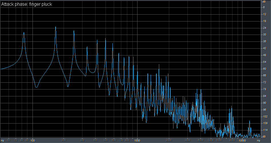

What about real instruments? Those are waves, too (it’s all waves), but they aren’t just basic up and down, they’ve got lots of little peaks and valleys and whatnot in each wave. Out in the real world, most things that vibrate (and again, that’s all we’re talking about - hearing things vibrate and make waves) have overtones. That means when, say, a guitar string makes a wave, it also makes a bunch of other little waves at higher and quieter frequencies that all add to the sound, so it’s not that basic eeeeeeeeeeeeeeee you get from a perfect wave. They’re more complex, but they’re still waves, up and down in a cycle, with lots of little bits thrown in adding to the color of the sound. They look like this:
See how it’s still going up and down, up and down? It’s still a wave that happens over time, but it changes over time and gets all crazy. Pretty much any acoustic sound (as in non-electronic…tuba, drums, guitar, screaming, beating on a can, etc) will look a bit like this, because it’s got a lot more going on than just a basic wave. Also, those extra bits are part of what creates timbre - it’s what lets your brain differentiate between a guitar and a piano and a flugelhorn and a voice, because they each have their own little additional bits that add to the color.
So a guitar string vibrating at 440Hz is the same note as a sine wave at 440Hz is the same note as someone singing at 440Hz…but they all sound different. And so here’s (finally) the answer to your question: You manipulate real instruments the same way you manipulate synths, because they’re all just waves - you add or take away parts to them. EQ plays a specific wave over the top of your instrument or synth or sample, and either adds or subtracts that part out (remember, waves add and subtract when played together!) A delay or reverb just grabs a chunk of that wave and copies it over a bit. Compression smooshes the amplitude (volume) of the wave so it doesn’t jump up and down as much, and on and on…
