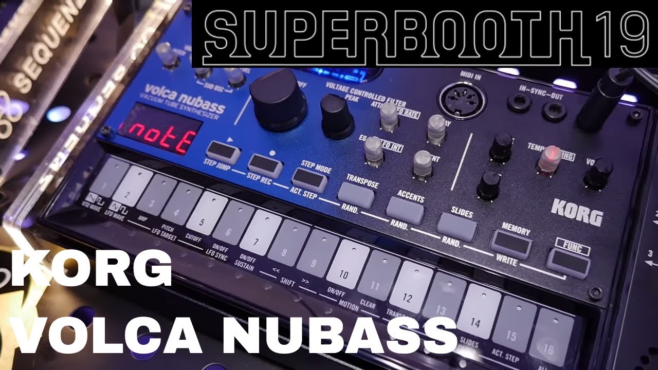

What can I say, the New Korg Volca Nubass looks/sounds the perfect tool.
If Josh Winks had one of these back in the day then his consciousness would of been in a far higher state :grinning:
