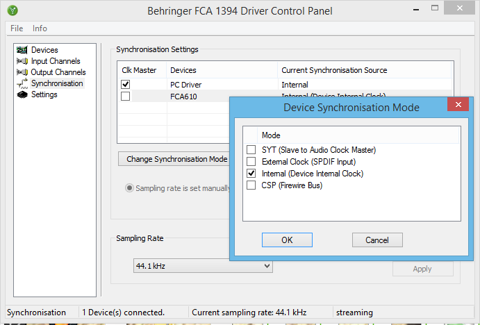

When I change the synchronisation settings (or sample rate) of the fca 610 then I connect the converter, the sound does not pass. As if the converter freezes. And if I just turn on the audio card and connect the converter, the sound goes, but with a noise and not at 48khz but at 41,000. Attached a screenshot of the settings. What is there to choose?

If you’re running into another interface and then your PC (or straight into your pc), you either want your DAW to be master clock or your interface, depending on your preferences. Ideally, you would then slave the behringer to the master clock with the spdif input. That said, I’ve never heard of clock issues causing noise like you’re describing (can’t listen for myself just now). Rather, incorrect clocking would just lead to the silence you are describing when trying to change it. It may be that you aren’t properly transmitting clock from the other end of your spdif, so I’d start by making sure whatever you’re plugged into is set to be a master a clock.

I set everything up. No noise. I had trouble with ASIO. Thank.

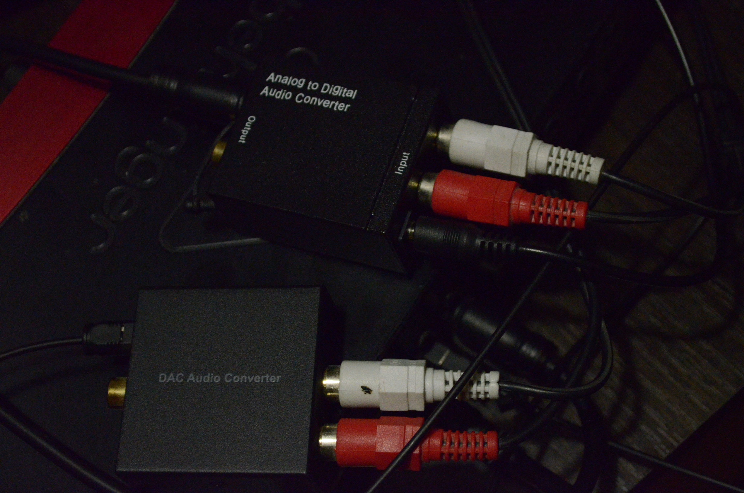

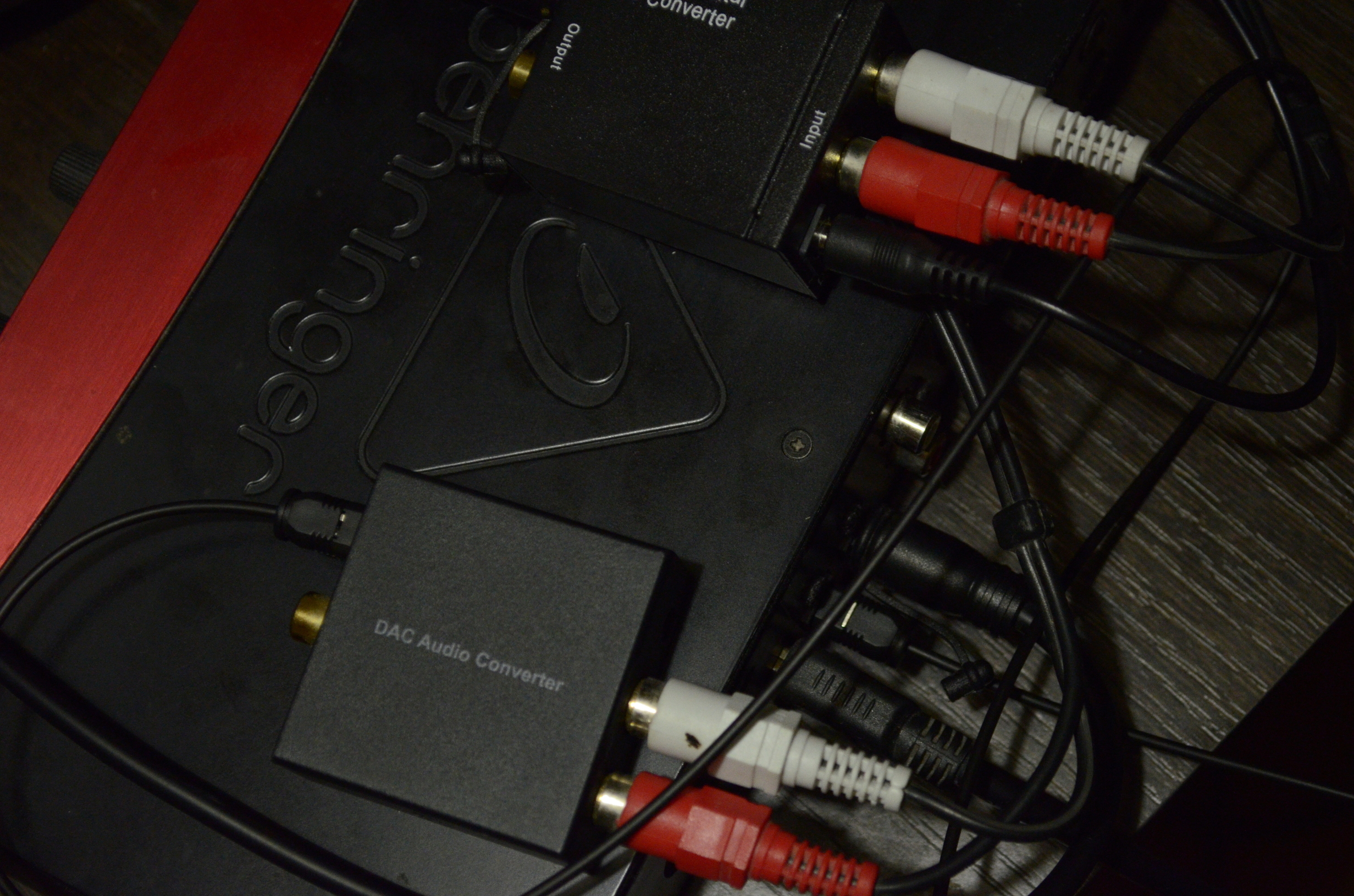

Just add pictures that were in that message. The question was about routing fca610 digital out-> adc → dca->digital in fca610.
