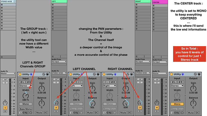

An other solution if you really want to use this Utility tool, is to engage [ Bass Mono ] so the low end is more focused, doesn’t blur the all image.
The [ Width ] control will then open the stereo image above the [ Bass Mono ] chosen frequency.
If i had to work with the Utility tool only, to control the image of my signal, this is how i’ll do it :

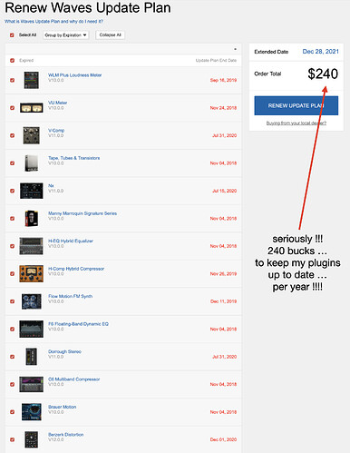

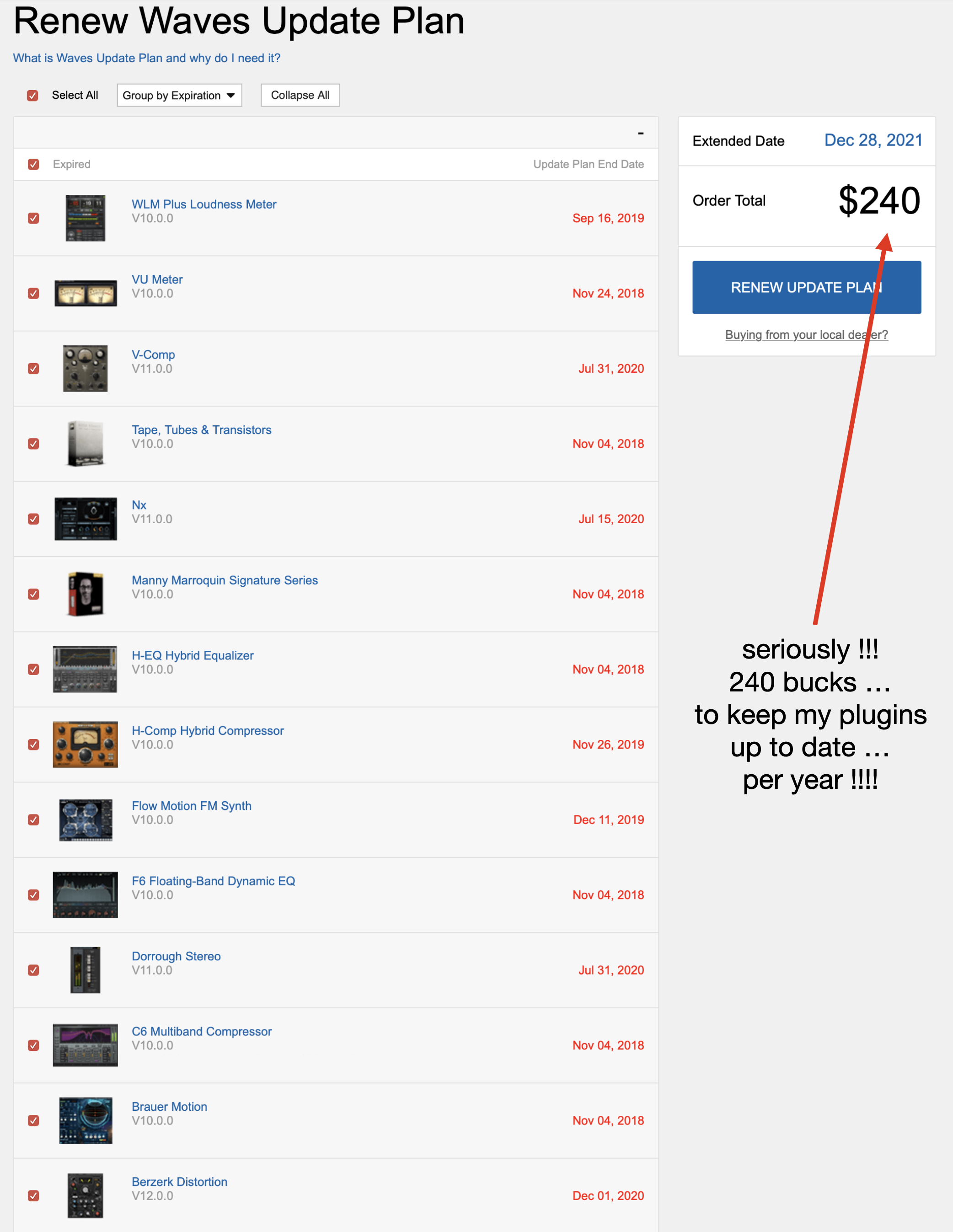

I did use Waves plugin a lot, i don’t know, there is something with the " glued " overall sound of their plugins that i really like … the only CONS with waves plugins : their bloody update policy which is a true rip-off, i sent so many mails about it to the HQ … their plugins are nearly free ( black friday etc etc ) but then, to keep them compatible over time, the price of the updates are just non-sense.

The trick w Waves is that yes they’d like you to update, it’s part of their business model, but it’s not necessary. I’ve got both v9 and V10 plugs in my system. One just needs to have both the current and “legacy” versions of Waves Central.
They sort of bury the legacy installer in their site, but it can be found. I also refuse to pay more than $30 USD for their stuff out of principle.
